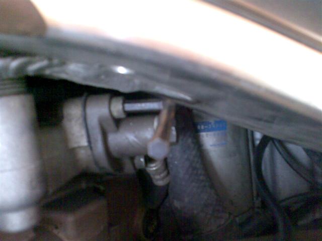

chain tensioner
Thanks Sam46 but you have to type so we know what you know. Is that a new cam tensioner? Were did you get it, (from dealer or net). Or did you change the little spring? How do you adjust the tension on it?
