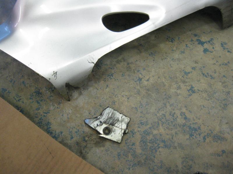

I added a new used belly pan because mine was broken. The bike is lowered and when I first got it, I bottomed her out a few times.

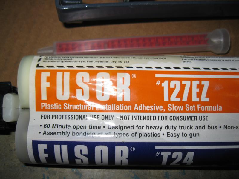

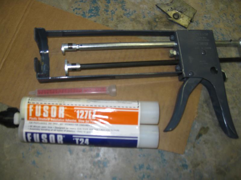

So I found a broken tab on the side fairing. If any of you do bodywork, you know about Fusor products. It requires buying or borrowing a $150 gun, and most body and paint stores sell it, but you can find it on ebay(slightly out of date, but useable) for way less money.

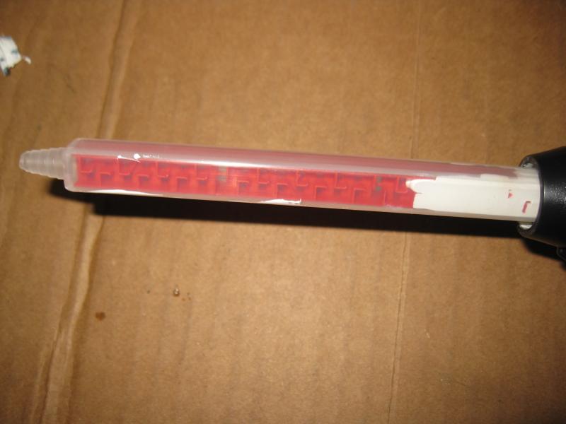

The tips mix the two parts and make a strong product when set up.

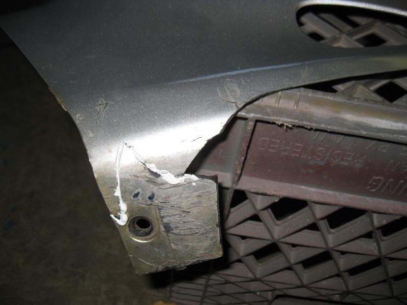

Next the special mixing tips and place the pieces together to set up.
This crap is strong as can be. Bodyshops also use the metal Fusor to attach 1/4 panels so the dont have to weld them.
