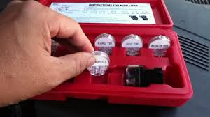

Ok so the pump is priming, it’s sending fuel to the fuel rail but no further. I absofuckinglutely suck at anything electrical lol but from what o tested there is no power at the fuel injectors. But I did put a known good ecu from a very good running bike and it did the same thing.
Kiwi Rider
Jun 12, 2017
7,406
18,633
Use a noid lamp to test for pulse at the injector connector harness side.
