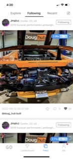

Yeah I’m not on Facebook or Instagram. I tried to post a screenshot of a local Denver guy’s dragy times but the resolution was terrible. His Instagram is Doug Hub and his twin turbo Huracan ran 60-130 mph in 2.95 seconds.
You and others have helped me so thanks for that. Initially I was trying to keep things “on topic” but I should relax on that. :)
