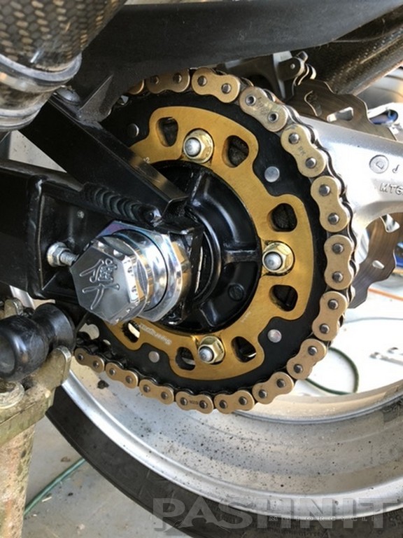

I've definitely wanted to try one for awhile, one thing I don't get is why all the ones I see on ebay and other places that say fit the busa are listed as 520. I know they have 530 just don't get why the 520 is even offered for the busa since the last I checked (not that I really looked) there wasn't a 520 chain with the tensile strength suggested for a Hayabusa.
