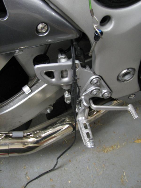

put mine in the tail section vent...easilly tucks up out of sight when done...perfect!!!
