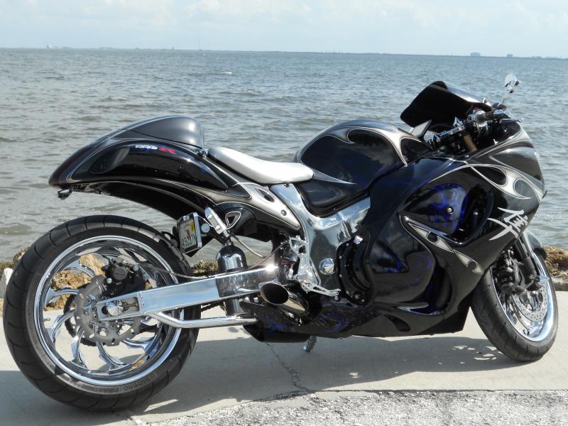

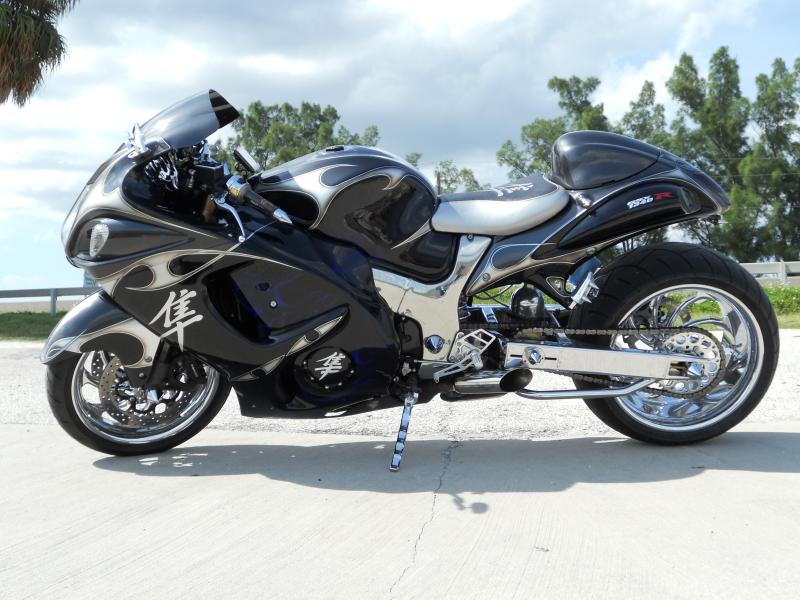

    i have the chrome atc heavy duty spring and i have a 9 inch stretch and i weigh 250 with no rubbing issue at all even riding 2 up but my bike is at stock height hers a pic and one before the paint job
