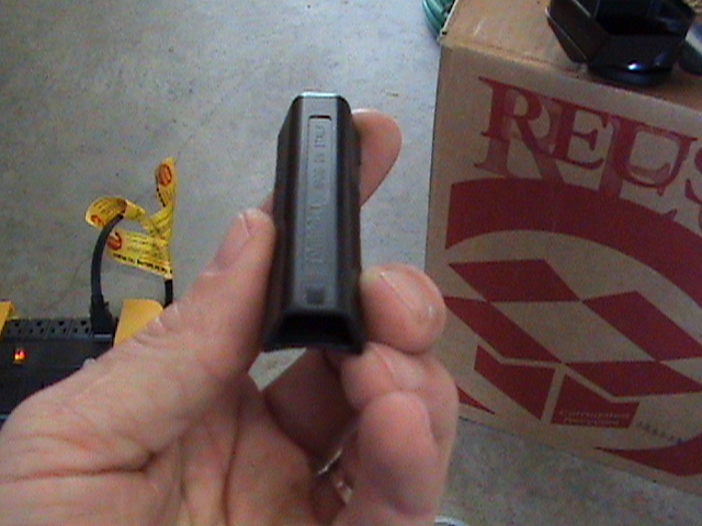

For those of you that have a rubbing problem, I have the solution for about $8.00 from your local auto parts store. I an going to try to post up pics of what I have done. If you have a steible,Nebulus or a BadBoy air horn the air pump will slide up from the plastic horn assembly.
KRUZIN
Feb 7, 2006
275
You can see the pump nipple that slides in the plastic horn assembly. There is a plastis locking peice that you can pry back a little to slide the pump up,don't worry if you break the little lock bracket as you will need to cut that off later..

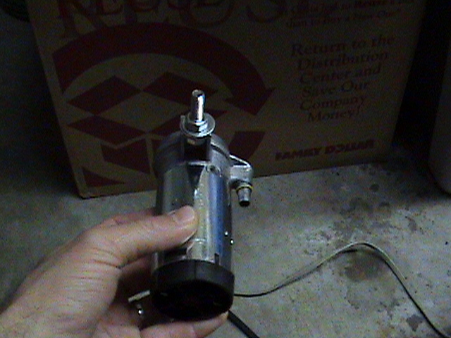

Next cut the side that has the air inlet on the plastic off but dont damage the inlet tube. You will trim and epoxy that peice back on to the pump..
KRUZIN
Feb 7, 2006
275
This is the inlet tube that has been trimmed and is ready to be glued onto the pump. Careful not to get epoxy near the inlet hole of the pump when glueing the two together...

Make sure you dont have the mounting bolt installed on the pump (you wont need it) But that part of the pump (it's the square part of the pump) when you zip tie the pump to the round pipe make sure that peice is to the right of the pipe to keep the pump from ever shifting to the left...
KRUZIN
Feb 7, 2006
275
Connect the two with 7/32" ID vacume hose, hook wires to the pump secure line and wires on top of intake tube of bike with zip ties and you are good to go.....I forgot to mention you will have to make the hole a little bigger in the horn assembly for the new nipple to fit in..
