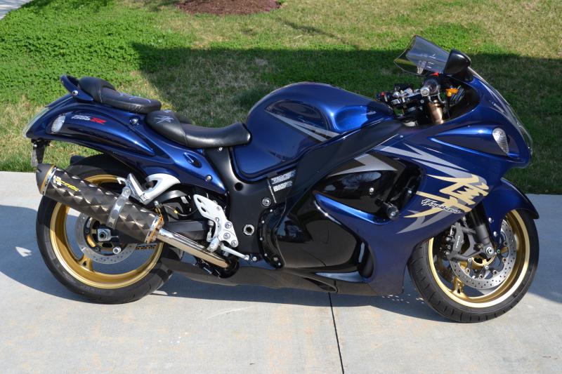

I have mine in the middle hole in the back and the forks tubes are about 3/8 of an inch through the tree. It give it a little rake towards the front and for me it looks great. Make sure you get the even. I used a depth mic. Here is mine
