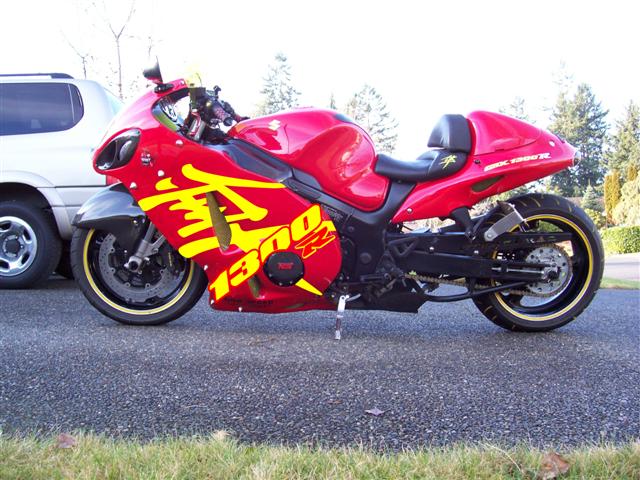

106
I'm 205 and it hasn't been a problem for me . I ride daily ( only transportation ) . I have a 600 3-9" arm (set at about 7" ) I've even rode with a passenger and had no problems but you will need to lower the rear . Mines lowered with adjustable bones from Goldenchild here on the board .
