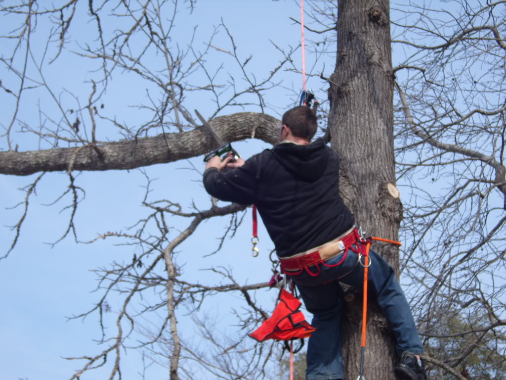

In the first set of pics we see Ken. He is about 85 feet up pruning a gum tree. The way we climb is simple, Climbing saddle, connected to a grigri, to a micro pully to a acender. Any how here is Ken in action
This was Mondays work. We pruned 8 gum, 5 oak and topped a pine tree.

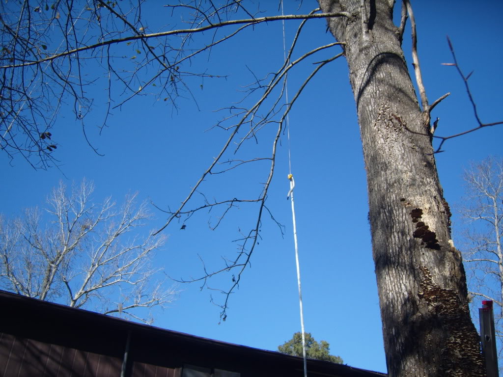

We get it all cut up and out the way and move on to the next part of the job. Removing the tree. In the first pic you see the throw line. It is a slick coated line with a 12oz weight bag on one end. We use a giant sling shot to send the line up in the tree. Once over we tie the bull line ( rigging rope) to the throw line and pull it down, there by making a loop with the bull line.
Ken setting the throw line
bringing up the bull line
Once over the tree we use a figure of 8 on the bight to made a girth hitch on the limb
