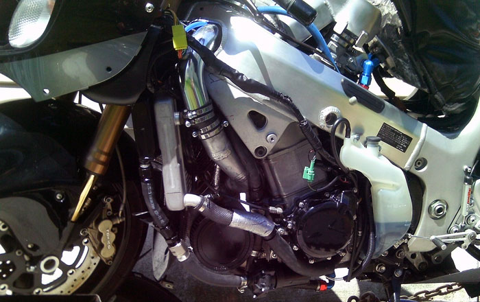

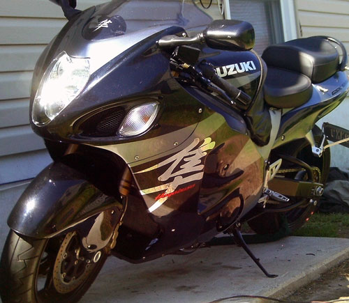

Heck of a winter, started gathering pieces in December, Feel like I'm coming out of Hybernation :laugh: Bike was turboed last year but decided to go a little higher on the boost. Had spacer plate, studs, undercut tranny, hight volume oil pump, degreed cams, hd shift shafts etc, etc, done last year. I pulled it again for some Wossner Pistons, Crower Rods, Robinson HD Output Shaft, Case Studs, New Bearings, Ape HD Valve springs, Crank balanced, counter balancer removed, Evo shift kit, and went wit a MTC multistage, Billet inner and outer, and most importantly Lee's performance windage tray :rofl: . It runs great I have about 250 break in miles on it with a nice base map done by Powerhouse last year. I though I was done..... but I found someone selling a a/w plenum with heat exchanger for a price I couldn't pass up, so I really went for broke and jumped on it... any how, the a/w plenum was a lot of work as well, plumbing all the lines, modifying the radiator, up pipes etc. etc. Just got the hold downs on and the horn back on. Horn had to be modified as well to fit with the heat exchanger. I got it the way I want it, so enough out of me here are some final assembly pics..... :thumbsup:
street bike, gonna tune it with 93 octane, Id like to break the 300 barrior on pump, any more will be icing on the cake, I want to get a feel for this plenum, Hopefully 16 to 18psi on pump. Might just shoot for 15lb tune to be safe. Want to get a feel for it first. Get some feedback as well on this. It's boost referenced through a PC3, Multifunction HUb, GM 3bar map, Walbro Pump, billet rail, 8an feed, S2000 injectors FMU, for anyone wondering about fueling. AMS500 running the solenoids off of manifold pressure. First stage on button, second stage through the HUb. Spring dynoed at 7.8

Nice bike :thumbsup:
