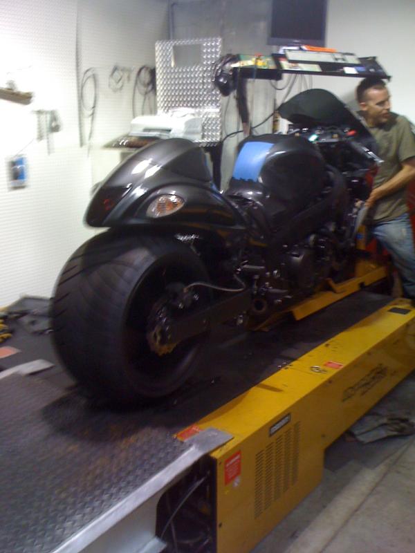

330 is the way no jackshaft. Love mine made some improvements but I am going for a crazy turbo setup to match it.
This is the way to go:laugh:
