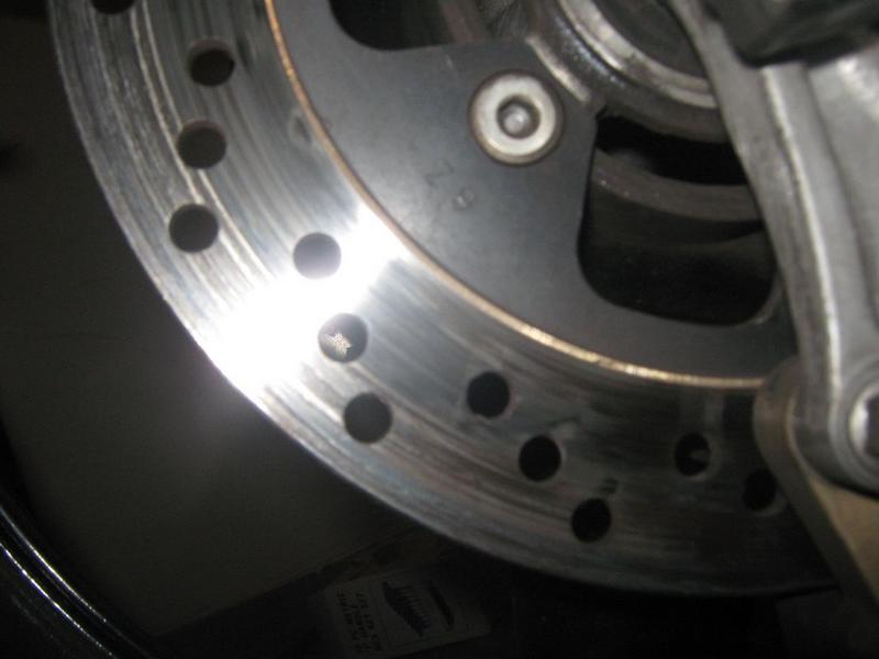

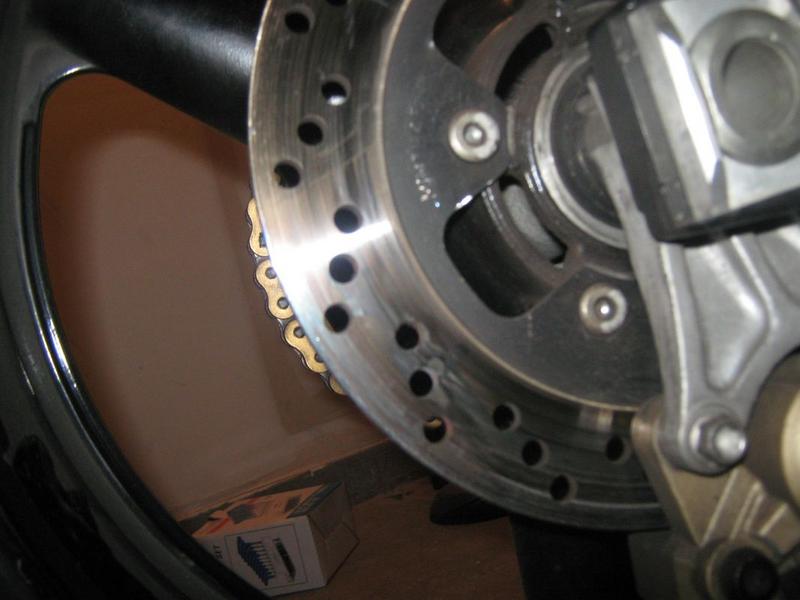

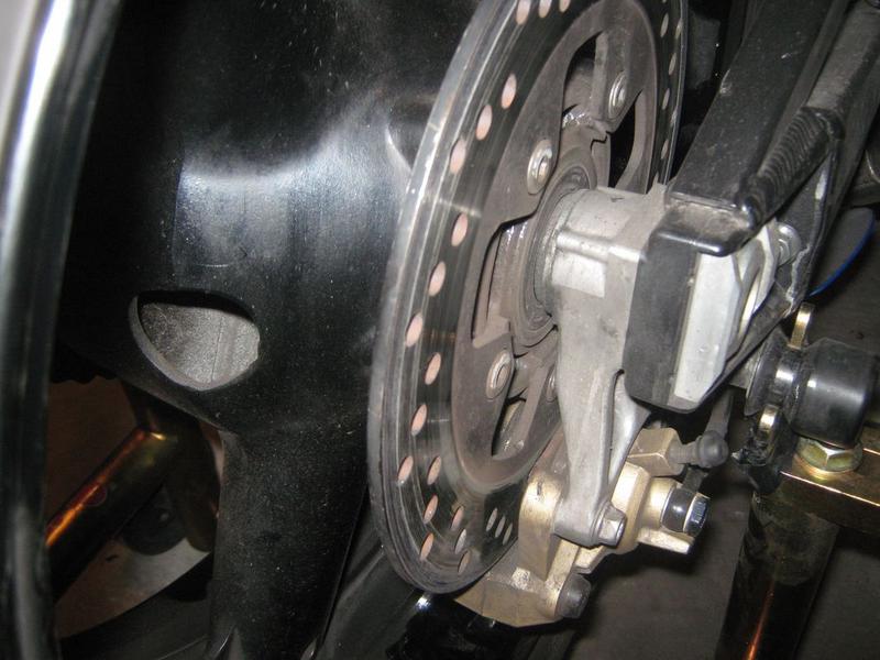

I think my rear rotor is warped, which suprises me because I hardly ever use my rear brake. I went out to the garage this morning to prep her for a ride, and when I took her off the rear stand to roll her foward the rear wheel would'nt turn!! I checked the rear brake lever and it did not seem stuck, I then (after putting back on rear stand) manually spun the wheel. It is really hard to spin for about 3-4 seconds and then it seems to spin freely for about 1 second.
I just rode her Friday to work and on the dragstrip and I did'nt notice anything unusual. Is it possible the wheel was spinning too fast while I was riding to notice this? Could it possibly be anything else?:banghead: Maybe this was affecting my times at the dragstrip!???

Rotor looks fine to me. Disengage the caliper,remove pads and put one of them between pistons(to stop them pistons before the exit of the caliper)... press the rear brake to expose the pistons as much as possible and clean them(pistons) with a solvant suitable for brake cleaning.Use a tooth brush or something like barrel brush to reach all surfaces.Then wipe the rest of the dirt...press pistons back in and engage the caliper.This will turn the pistons loose and your weel free :beerchug:

Thank you for your help and suggestions everyone! I actually sprayed brake cleaner on pads and this seemed to help, I was able to roll the bike alot more freely. Tomorrow a buddy of mine and I will take a closer look at things, he owns two Busas himself and has a small shop space behind his house.
I was able to go on my ride and I encountered no further problems, but it still sticks in some areas when I spin it on the rear stand. I will no doubt have to inspect the other possibilities mentioned. Thanks again!!:bowdown:

You didn't mentioned, does the rotor look warped? as its spinning say when the bikes up on the stand.
