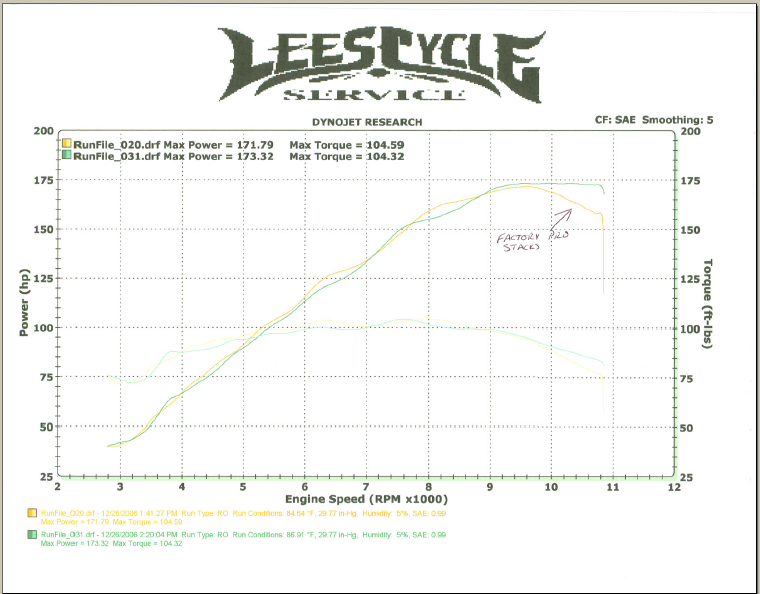

I know this is an this is an old post but wanted to throw my two cents worth in. I tried the Factory Pro velocity stacks and they were a waste of money. You are better off using 4 short OEM stacks and they only cost a couple of bucks each. By using the Factory Pro's it actually cost me HP.
With Factory Pro's
Short Stock OEM's
