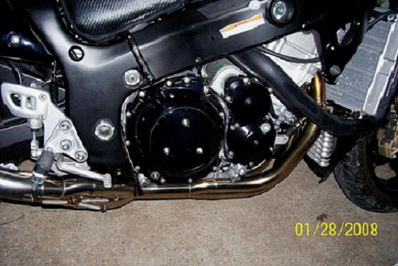

These pics I got from BusaDale at EBC. He had the same problem.
I have had 2 Tsukigi Spec 2's on my Busa's, Same clearance problems, You have to adjust the pipes after getting them on, Move them around a little bit at a time to get the proper fit, No matter what you do , You will have to trim the fairing's to make it work, You will also need to put some sort of adhesive heat tape on the backside of you fairings. On my busa I am running it without the belly wing. If you have any more problems try and give Steve @ Smithers Customs a call and he can probably help you more. He installed both of my Exhaust and did a great job, I have had no issues with my fairing's or anything else. His number is 1-913-768-8667, Hope this helps.
