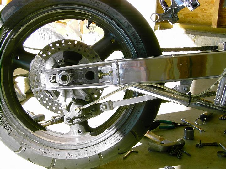

You will NOT need the support bar that is referred to up above because the caliper rotates as you extend the arm out... Thus the caliper will not be sitting in the same position it is stock... I know it doesn't sound like it makes much sense, but when you get into it, you will see what I mean... ;)
NearDeath
Sep 7, 2003
1,480
Here is how I did mine... Notice how the caliper is rotated forward as the wheel goes back...
