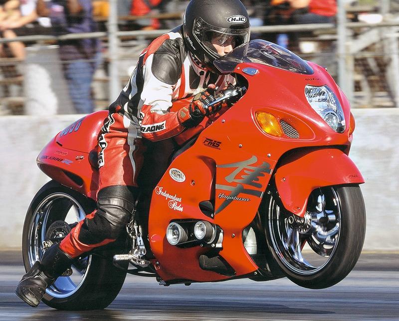

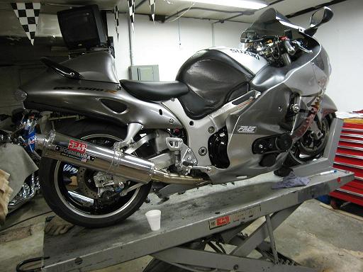

i just got this months issue of super streetbike in the mail, on page 84 theres a naked 08 busa sporting a big cc charger with a built motor and its only putting down 281hp!? for the money this guy put into his motor i.e. low compression 1365cc motor with all the cams and goodies to go with it, hed have so much more power if he just went with big cc's stage II turbo kit ??? what gives
I have to speak out for all superchargers, They will never make the power a turbo make! Given the same parameters. They have what I call usable power. Which makes them more ride-able
Look at the times I can do in the 1/4 mile, compare them with a turbo and I bet they are making more hp to do the same e.t.
As far as numbers, it makes 310-320 ish to the rear wheel when a lock up clutch was installed. No intercooler or water injection. It rarely sees a dyno because we tune by data logging.
We have an intake cam on the ex, which is being replaced with a stock cam now, we believe the 2 intakes hurt the power. drop in je turbo pistons, hd valve springs, good rods, bigger injectors and fuel pump.
They are very easy to ride, nothing different from a regular bike except a lot more power! This one is a little intimidating but the street version is smooth, and fast. This one came in with an already 2 mil bore, all we did was put in turbo pistons and he opted for turbo cams, nothing else and it made 256 to the rear wheel.
