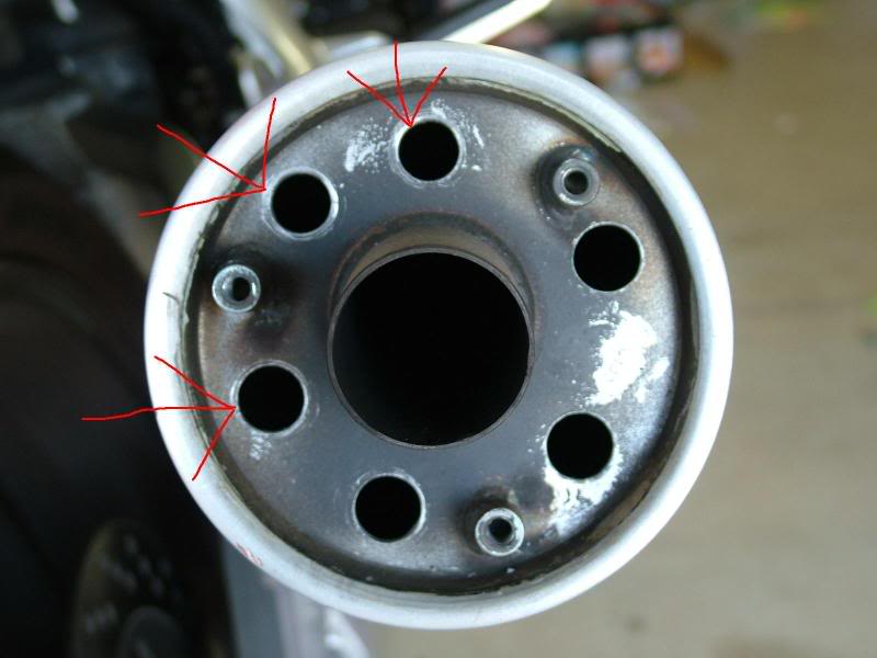

Well just did this mod I found here in the graveyard of the Mod forums and the bike just sound GREAT!!!
Did 9 1/2 holes instead of 6.
Removed the bolts with a dremel
Drilled 9 instaed of 6 1/2 holes
Sorry for my grammar, I'm french, hey nobody's perfect! ;)

for the lean/rich I'll tell you in a week, I'm up north too but heading to Daytona next friday. As far as sound goes I found it sounded wayyy better than stock and the mod toke me about 30 min to do with proper equipment, air dremel and drill.
It isn't enough of a difference to affect the A/F ratio (I have 9 3/8" holes). It's more like 10-15bminutes with a dremmel and the exhaust note is definately worth it.
The sound is GREAT!
What I did was drill the front end baffle plate with five 1/2" holes each (long drill bit) and then after removing the rear end beauty caps, drilled nine 1/2" holes in the rear baffle plate, three each between the screw posts. Masked and painted the ends with 1500 degree paint and reinstalled the screws. Doesn't look bad at all either.
The only possible performance difference I (think) I felt was a reduced back pressure feeling on hard decel at high revs. If I did in fact feel some difference, I like it. Not the usual lurch forward when down shifting like the very restrictive stockers seemed to do. Acceleration was not effected. Looooove the sound, really. Would like to hear it from another's perspective and not just from the seat but I really do like it. No pops or swooshie sound, just a nice deep throaty rumble.
