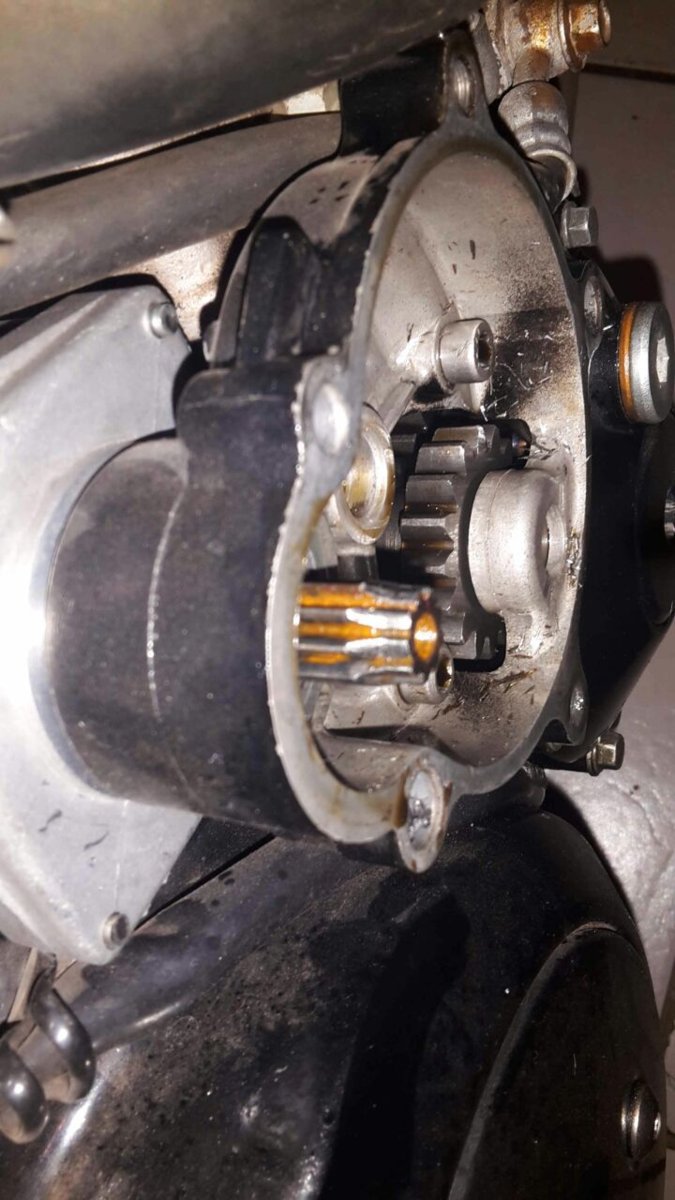

Starter Gear Keep On Stripping, What Can Be The Fault??? Any Help Please

Check that all the needle rollers are in the captive cage, that slides around the shaft, something is out of alignment or not supported correctly.

I
You need to upgrade to 03 and up gears and covers, and starter!
was considering to do this mod to mine but haven't looked into it, I'm getting that ominous 'kick back' on the odd occasion, so, I think I might look into it.

Im replacing a set of cases for the Kick Back my customer had,,,

Gears and covers all the way to 2017 is what you need, and a starter for 03 to 07
So, I need to search eBay for a gen 1 (03-07) starter and gen 2 covers and internals?
