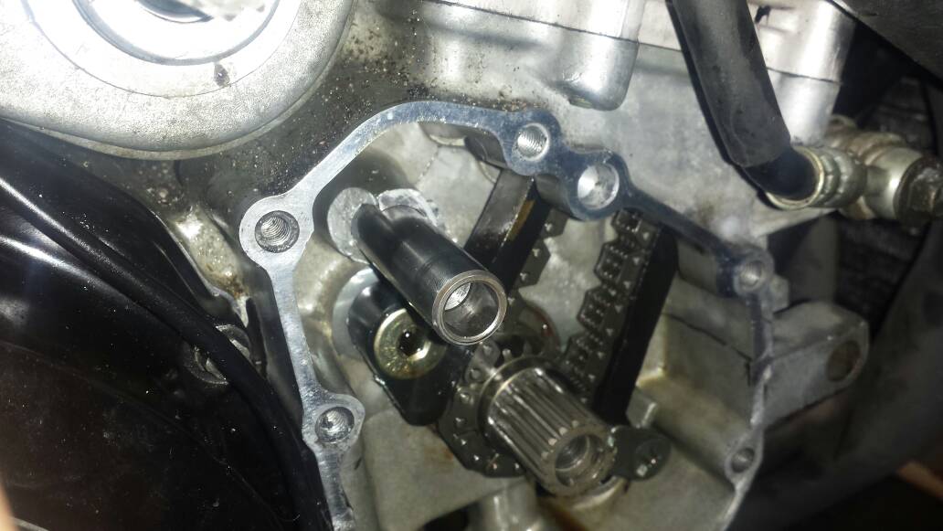

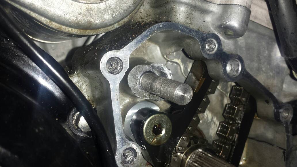

So I got my bike back together finally after a very long time. I had my transmission undercut, valve adjustment, and a lot of other things, went to start it up and I hear a sound of something breaking, figured I'd see if the engine still turned over nicely, it did, but before that, I discovered numerous cracks in my starter covers. I believe there was a preexisting crack from when I was digging in there before, but had no problems since. I ordered new covers and plan to have a shop with a lathe make me a piece so I don't have to buy a new motor.. Any ideas how the hell this happened? After spending $1200 fixing and maintaining the bike this past month.. Needless to say, I'm pissed.

I've already ordered both of the starter covers+gaskets and plan to have someone make me a pin to go into the case and starter gear pin so I don't have to break down the motor AGAIN, and send out the case, seems like a real good way to go about fixing this.

Not really, like i said some bikes had the major flaw, yours appears to be a kick back problem. Witch a lot of time the gears just rip teeth off, or what has happened to you.
Now for the fix, all covers and gears, pins and washers and starter from a 03 and up.
As for the case, now thats a problem, either you need a new lower case, bearings, to do it the correct way, or a good welder, and machinist that can repair the broken post!

I spent some quality time in the garage fabricating a pin on the lathe to fit into the existing hole, cause I really do not want to buy a new case thank you very much.. Then I spent money on eBay and amazon, bought the full set of 03+ covers, gears, etc. And a lithium battery off amazon, 290 CCA for $105 ftw
Your better off welding the broken piece back on then uses the case saver, as well as your pin
