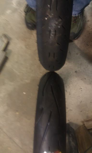

Installed the tires last night and took some pics of them compared to some other tires I have.
Front compared to the Shinko 003
Front compared to the Michelin Power One.
Front compared to the Bridgeston BT-002
Rear compared to the Michelin Pilot Road (the only other 190 rear I had lying around)
Rear mounted and inflated
Front mounted and inflated

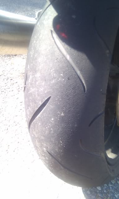

I'll probably add some more tomorrow but in the interest of getting some sleep I'm giving up for now. I leave you with a couple of post ride pics.
Alright.. Now that I'm semi rested and had a few days to process Sunday's ride a few more words about the 010's.
Plush is the way I'd describe their feel. you still get good feel from the front and rear but it's not as telegraphic as I've experienced with the BT016's. Not to say that this is a bad thing. It's like the difference in having someone poke you in the hand with the sharp end of a pencil vs. the eraser. You feel both but they are different. When I would push these tires into the corners I could almost feel the tires flexing to conform to the road surface. Push harder, feel more conformity. There is really nothing about these tires that I felt that I disliked. They turn in faster than the Shinko 003's, feel more stable than Pirelli Diablos, felt more compliant than Bridgestone BT016's and felt better from cold than Bridgestone 003's. Ok.. the opposite end of the stick. They don't give the feedback or the 016's or Diablos, probably don't have the magnetic grip of the 003's, and might not outlast the 003's but I don't really care. I think these tires are very good. The only thing that might stop me from buying another set would be longevity and honestly I can really fault myself for some of their accelerated wear. I've had to make two spirited trips on 4 lane highways since I put these tires on the busa and going 50 miles one way on a sport tire at the speeds I was travelling (no admission of speeding here mind you) would tend to take it's toll on the center of a tire. In the twisties I've got no complaints.
