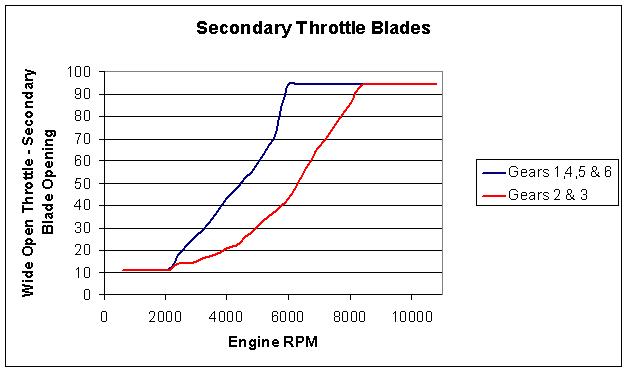

jefro
Oct 22, 2007
920
12
Here's a chart by Smithabusa comparing the opening rates by rpm in the different gears:

??? I am running ECU editor, I will have to look into this... well maybe I will just remove them all together...
jefro
Oct 22, 2007
920
12
Here's the thread on it: STP - ECU hacking
Still in the experimental stage but shows alot of promise. Also looks like traction control(a basic rate control mainly for launching) may be right around the corner :thumbsup:

smithabusa
Site Sponsor
Jul 24, 2003
4,591
5,431
if you are reflashing, you can remap the STPS pretty easily so as to not have to remove them, i would recommend looking at the tune, if there really is anything to be gained (I dont honestly know, but dont think so) it should be tuned for.
My 08 Turbo bike with very low boost (195 hp) it made no difference with stock STP mapping or cranking them wide open on back to back dyno pulls.
I have also messed around with 3rd gear roll ons with 6 psi of boost both with 3rd gear stp mapping (much lazier than 1,4,5,6 gears) vs 1,4,5,6 gear mapping, and i can't see much of any increase in spool time even though STPS dont get fully open for another 2000 rpm 3rd gear vs 1,4,5,6
