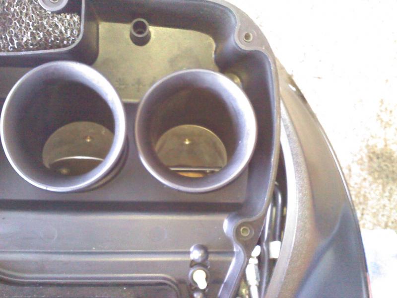

After reading a thread on here I decided to remove the secondary flies on my Gen II. The removal goes as follows: Take off seat... Take out the tank hold down bolts and prop up tank ( I use a stick to make it higher ). Then take the airbox lid off and set it aside ( phillips screws ). Now you can get to the flies from here. What I did was to close the flies with my finger and work on the other side away from where I was holding. Two phillips screws on each plate is all you remove to get the plate out, I highly suggest a magnetic screwdriver. If you happen to drop a screw the other throttle body plates will keep it from going into the motor as long as you don't twist the throttle. Now after the four plates are out just put it back together.
My review of the performace is.... it does feel like the throttle is more crisp. I only rode about 25 miles so far so I will update this. I have tried a TRE and this mod feels about the same as that. I don't have a TRE anymore so not sure if this adds anything on top of one. I have no idea if the A/F is still ok but the bike does run fine with no flat spots or issues. I did have the bike running to watch the flies and they were closed even when I thottled it up some ( not sure what RPM they open ). When you get to them they are open but if you start the bike they close... not sure if it was due to the bike being on cold start? Anyways if anyone else wants to add to this ... please do.

I asked the same question to Brock and put it to Brocks forum and got a resounding NO do not take them off on a Gen II (GenI and ZX yes?!?) - only thing is I asked "why" several times and never got an answer except Brock said it upsets his mapings for the PCV and his CT pipes so thats about all I can add - would love to actually get a technical answer though all I have ever seen is the above "seat of the pants" comments
Well I just got back from some more testing ( seat of the pants ):whistle: It is snappier... not a huge amount but noticable on mine. I will compare it to the Ivans TRE I borrowed and tried out. Pretty much feels exactly the same way... I wonder if the 5th gear map that the TRE uses has these flies open more to create the same feel as with them out. This would be in my opinion a better way to get the extra throttle response without using a 5th gear map all the time. I hope someone who knows the answers will chime in. I am curious when the flies open all the way ( what rpm ) and what gears. Thanks, Dozer.

2. Removal of the Secondary Throttle Plates IS NOT RECOMMENDED on the New Busa and the maps included ARE NOT intended for use with the plates removed. The 2008 Busa is as close to factory RACE BIKE as you can get...the secondary plates are used to smooth the power NOT restrict power as occurs with other bikes (like the ZX-14). At this point, we only see them functioning with the mode switch and low cruising speeds for emission purposes which are eliminated with the use of the power commander, our mapping, and jumper plug. "
Sounds like they could be removed, Brock's map's just aren't tuned specific for it, though. If the Power Commander disables them, then they're just slabs of metal sitting in the intakes? Maybe they still have some benefit. I'd like to hear more detailed input as well.

Well you can set the stp with the ec editor. They are set at 100 at 800 rpm. Dont Know the ansewer but there is still a lot of air restriction with those STP plates and rods. In pro stock even the screws are rounded off and polished.

Yes, there is a difference. My 08 has the stock tune. There is a noticeable difference in low/mid power in 1st, 2nd, and a little in 3rd. It isn't a big hp gain, but the bike lifts the front much easier. I had no problem wheelieing stock, but this makes it much easier to do, which is why I did it.
I was also suprised to see that it DOES accelerate much faster on the big end. I assumed with no tune surely at some point it would stumble, not so. With nothing restricting airflow, the needle pegs much sooner.
The bike feels the same throughout all gears and rpms, it doesn't seem to have lost anything anywhere. But I cannot say that for sure as the bike has never been dyno'd.
I originally posted this as a wheelie mod. One of the reasons for the secondaries is to smooth out the power delivery. The Busa is in the sport touring class anyway, it wasn't meant to be wheelie happy.
I'm not qualified to say, but I would tend to think the Busa would benefit throughout the entire rpm range with them gone...with a proper tune, to ensure peak performance. Even though again I've had no problems with them out and no tune.
