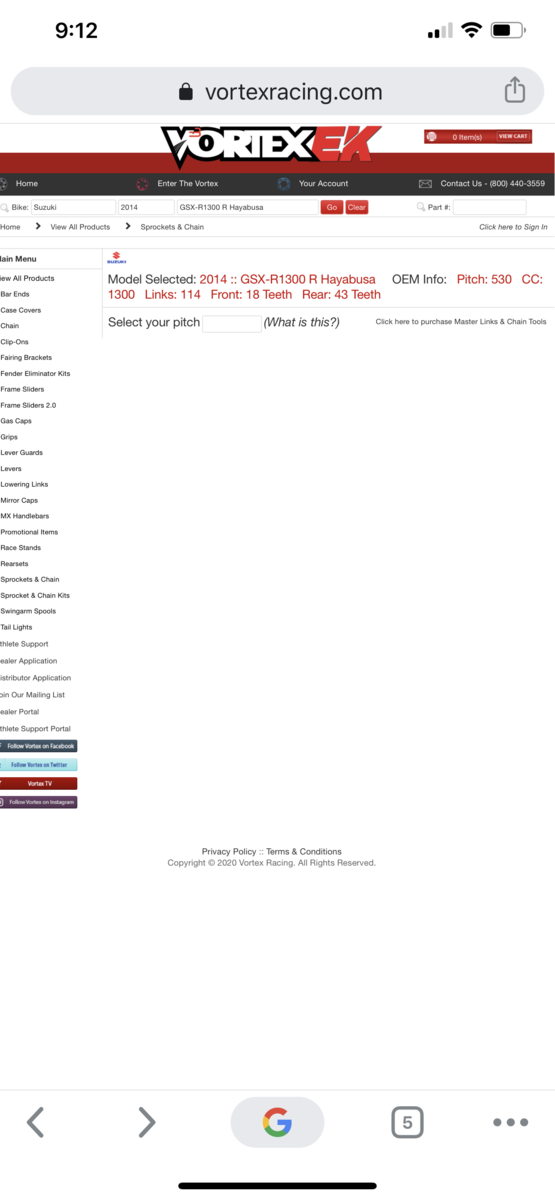

I’m on vortex website and asking for the pitch . Not sure much about that but . I’m getting a swingarm installed . So not sure the person is giving me the chain that comes with it . Just end to get a brake line

If you are getting an extended swing arm on there, better make sure you get enough links. I would buy longer than required, place it over the sprockets and cut it down to size if I was the one installing it. Too expensive to accidentally buy too short of a chain because you misjudged the wheelbase or go with a larger sprocket. For extended swing arm,it will be more links than stock. Offhand, I do not know the number of stock drive chain links nor do I know the number of teeth front and rear. My supplier just lists them as being for the 2008-20 busa and Bking. You are wise to confirm the number of teeth and pitch though.
Busa is 530
Yes, I have always been told to stay with the stock chain and sprocket pitch for the busa and the ZX-14. You can shed over a pound of rotating mass by going to a 525 but it is not considered safe with all the torque the big bores make. I try to be extra safe with chains and sprockets because if something goes wrong, it will probably go without warning and you or the bike or both will get messed up bad even at low speed. Had a friend who's gal pal had a chain come unriveted right after installation and it whipped her leg and dented the gas tank. That was probably the best case scenario. The chain usually does not fly out, it locks the rear wheel and high sides or winds around the front sprocket and chews out the motor.
Berlin Germany
Yeah, the Busa is a 18/43 tooth count and 530 pitch chain with 114 links. (...)
differentiation please
gen 2 - yes - 18/43/114
gen 1 has 17/40/112
both pich - 530
D.I.D. (ZVM-X) not available at your country?
this we all recommend here in germany (+ an automatic chain oiler - that easily doubles or triples the chains life)
chain life - with autom. oiler - my experience is around 50-70k km / 31 - 43k mi

i see one on amazon. I'm installing a swinarm So i need to find out how long i need it to be
