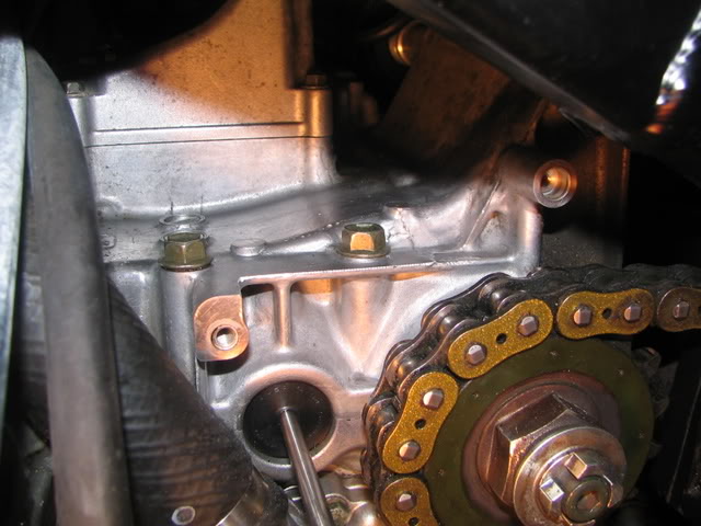

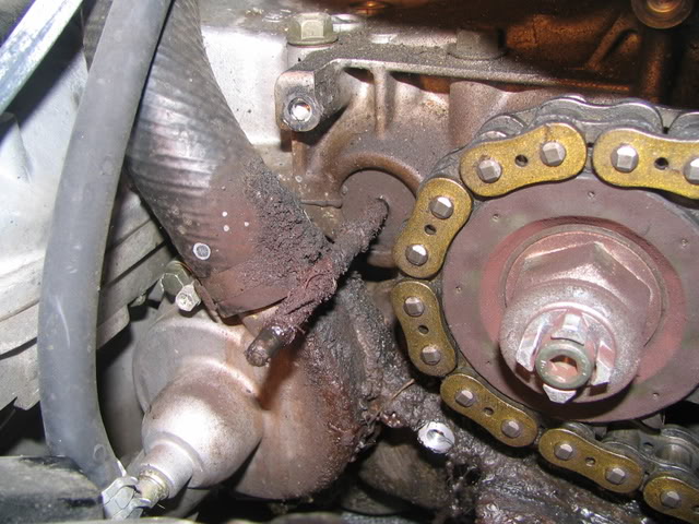

Here are a few pic of the area cleaned up when I cleaned my last year or so. Have no clue how you'd get a new seal in there, but it probably wouldn't be too difficult to get the old one out. Make sure it's not leaking from behind where the water pump goes in too.

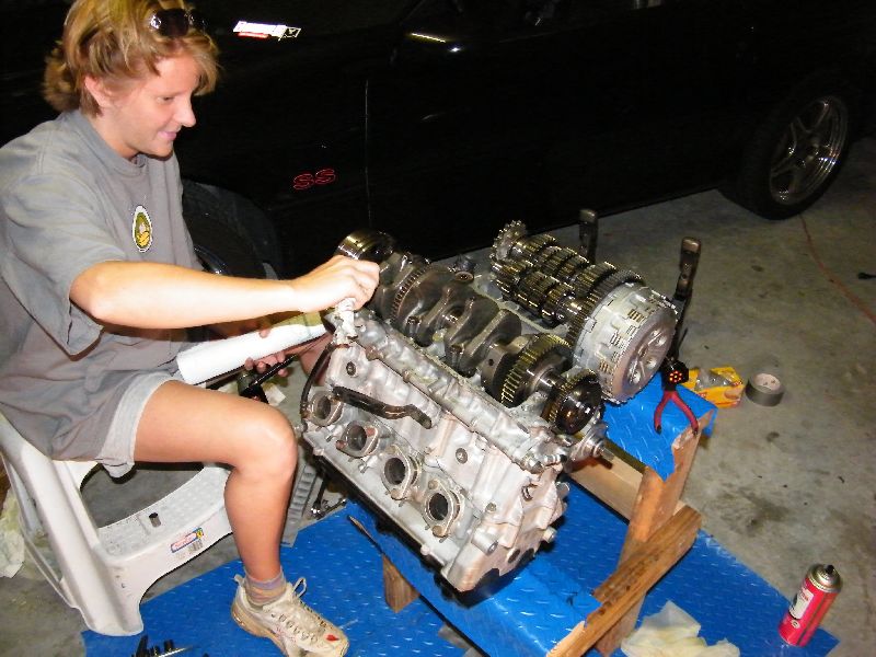

again, how did i get talked into this? got the case apart tonight. wifey stayed up to help too!

tobe wanted to help, but too much oil and antifreeze around, sorry pup.

Are you scared yet? Just make sure the the transmission shafts turn smoothly, and that you set the shift drum for neutral before reinstalling the lower case!
Also do not use silicone sealant for the cases!
