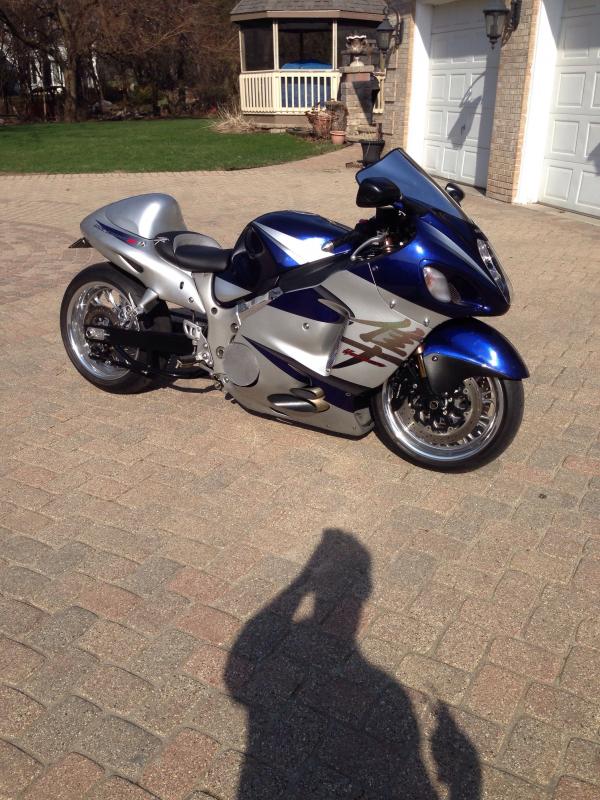

Here are some pics, more to come

Thors hammer......... I never heard that one I like it. Nice bike man. :beerchug:

That's nice, glad you got it all straightened out. Kudos to Frank and Powerhouse! :thumbsup:

very nice. impressive. who's this Frank guy anyway?
