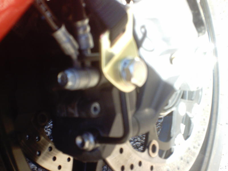

anyone know how to attach lowering straps to the front of an 08 i got them from Speed Needs the directions said to attach to the top of brake callipers but it doesnt allow the bolt to tighten down any advise

you can buy a mounting bracket for the strap

thanks for the advice,but instead of putting them on the brake caliper,i attached them where the reflectors used to be,did a couple test runs still comes up but no more than a couple inches with a semi hard launch

The 1st gen busa you could mount the straps to the top brake calliper bolt, but the 2nd gens are radial brakes like the GSXR1000 and require a bracket. Get the bracket is my suggestion.

thanks for the advice i will be ordering the brackets,the brocks from shnitz motorsports thanks for the link jefro

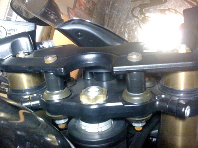

i lowered mine by raising the fork tube and it took 30 minutes. cost was 15.00for hardware..

are you on the coast, those bolts look a little rusted???

i did it this way cause i only want it lower when i drag race
