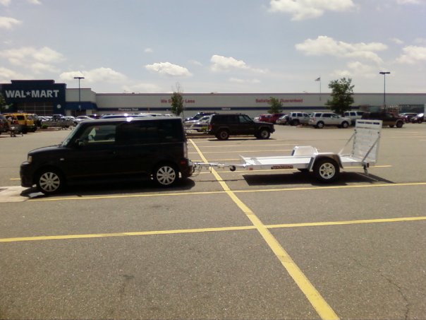

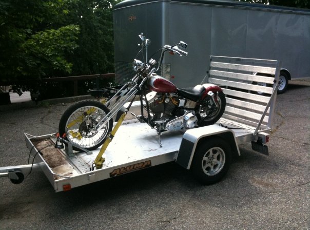

buy a trailer
Would like to buy a trailer but its not in my budget now. Besides need to do whatever before next weekend.
lowes has these:
Shop Carry-On Trailer 5' x 8' Mesh Floor Trailer with Ramp Gate at Lowes.com
or spend about 3 grand aluminum (12 ft) or 7 grand for the enclosed (20 ft)
I get great fuel mpg with the aluminum. (little over 200 lb) and may be selling my enclosed
I would like to get an enclosed trailer later on but again not in budget now. Looking for some relatively quick solutions that I can fab up this week for my trip next weekend.
