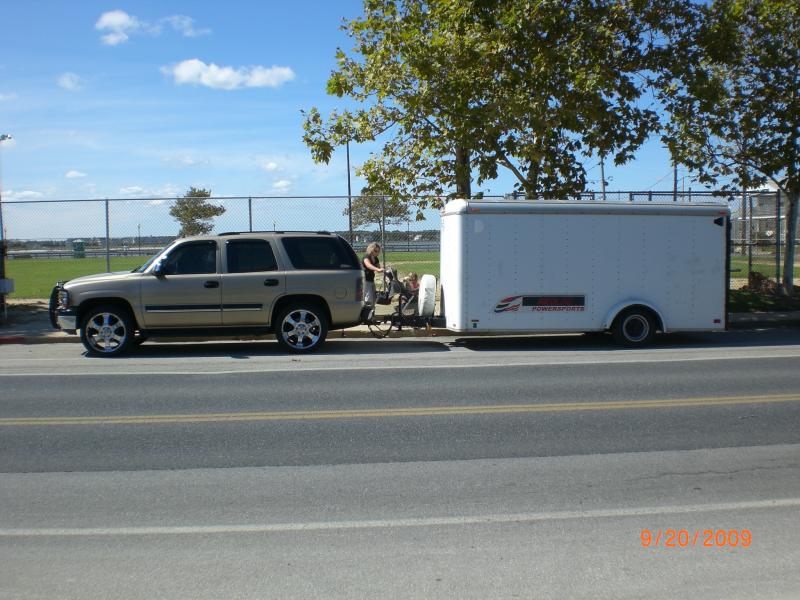

Go with a trailer. Way easier plus you can use it ti haul whatever you want when not hauling the bike.I used a open utillity for years hauling my toys.Boought a used 7x 14 enclosed 2 years ago for $1200 with 3 removable Pingle chocks and 9 drings for staping bikes downand a carpeted floor. I installed e tracking down center and sides of floor for strapping options
