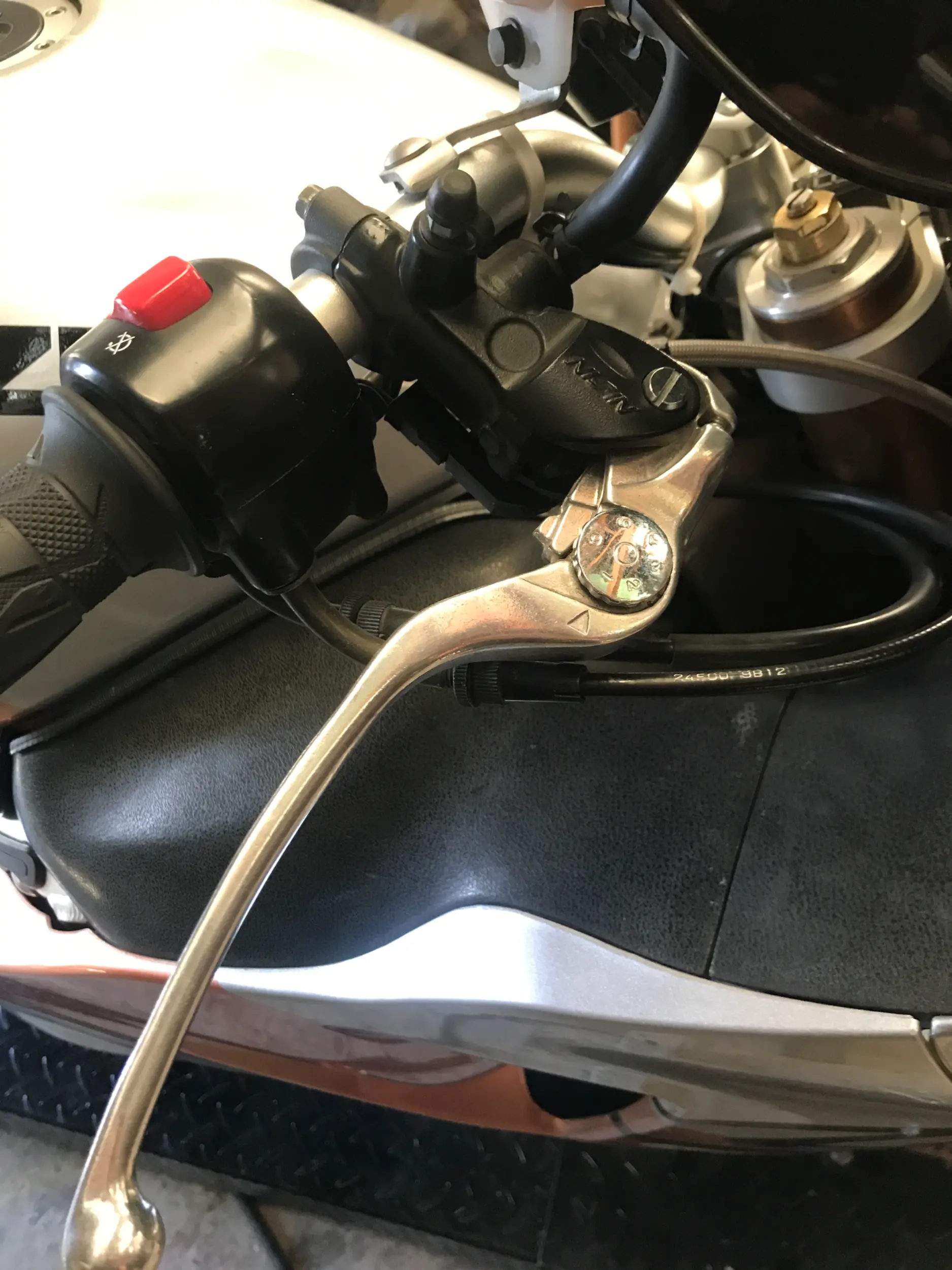

Thanks guys, i had toyed with putting the brakes back to standard at first but the looks have grown on me

I think it already has a radial mc on it
(I know factory is not)
