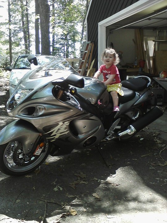

I took the bike for a short ride today. It doesn't seem as bad today but then again I wasn't at highway speeds for an hour either. I decided to ride it a little more spirited as I used to follow the brake in hard method with turbocharged cars in my earlier youth with no ill effects. The bike really is a blast and I don't think I managed more then 3/4 throttle. Changed the oil to 20-50w as I read that some had some luck with that reducing vibrations. Love all that metal in the oil on a first oil change! Will take it out on the highway tonight or tomorrow to get a better feel for what was going on. Yesterday I think compounding that uncomfortable vibration (it comes through the seat too I realized) was being a bit worn out when I picked it up from being a bit sick. I talked to the dealer and they definitely want to see it ASAP. I'll have to figure out getting it back up to them 1.5 hours away next week somehow.
Here is my 18 month old trying out the Busa.
My God Man...I'd know that kid anywhere. Steals bikes then kills the family! It's a good thing you found out in time.
Great looking KID and the BIKE, also!
