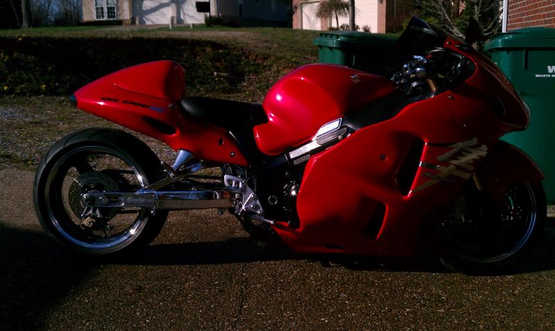

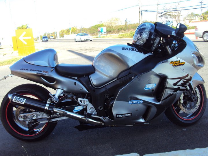

Thanks! I'm going for a hook up tire after this one is gone...here's my bike...nevermind the road rash...lol

All done, looks great and rides great with my new Spring. TracDynamics rule. Hopefully Im posing my pic correctly. :please:
