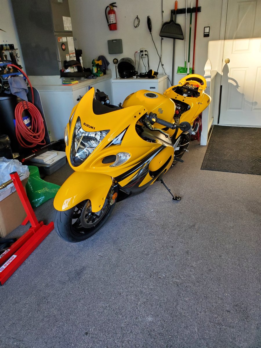

Hey guys, I've had a real problem with this kickstand and I'm not convinced that it's fixed. It works and gives me a good lean angle but when up it's awful close to the peg.
When I put it back to stock I pulled the Brocks track stand off and bought a used oem stand off ebay. I wanted to leave the original stand mount on the bike because I couldn't get to the switch connector.
When I put just the stand on the original mount it was clearly wrong, stuck way out.
I pulled the original mount off and found a stack of washers about a half inch high under the lower mount bolt. Pulled those out and it now sits as you see in the pictures.
Is it right now or did they also bend the original mount?
wreckwriter
Dec 30, 2022
1,196
1,524
It looks OK to me.....
Can you see any cracks or anything that would signify an issue with the mount?
There are aftermarket foot pegs on it as well.
No, can't see any cracks and, comparing it to my other mount (the one from ebay) it doesn't look bent.
Yes, they are Buell pegs I'm told. I guess with oem pegs the stand would be farther from my foot?

Looks like the kickstand mod may have been done too(which is good, some material ground out to let it swing further forward), but I can't get the picture big enough to tell for sure.
