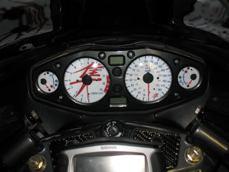

Got the reverse busa gauges done by bluegauges (in '06)
Of course at they black out and the numbers turn blue with red led needles.
It came with a SRP switch/dial.
the switch changes the lights from dark blue to teal and
the dial increases/decreases light intensity.
About 6 months ago the SRP unit began acting up when wet, live in fl...tons of rain. It would work fine after it dried out.
Well, it appears to have craped out. I got no lights at night time.
I'm thinking I can take the bugger appart and just "hot wire" the color I want and the intensity to full...which is where I leave it at all the time anyway.
Anybody else have any issues and/or ideas?

I live FL. also mine has gotten wet an I wash the bike with water an soap hadn't had any issues with either of mine.
1slowbusa
Jan 2, 2009
135
I had a set of idiglo on my bike and all of a sudden they quit working. So i took them out took them to work and hooked it up to a 12V power supply and started testing. Found that there isnt any voltage coming out of the transformer. I cant find the transformer anywere to buy, and not able to take apart. So i went back with the stock.

A belated update...I contacted Scott (I think) at illumiglo bluegauges and
got another SRP switch for about $25...swapped it out and all is golden.
Been working flawlessly for the last 6 months or so. Pretty easy and cheap
fix really.
