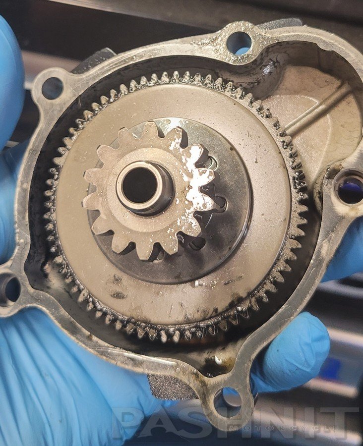

I push-started my Gen3 for 5000 miles, until I replaced the Torque Limiter Assembly with a new
stock Torque Limiter Assembly I got from Partzilla.
Nothing would make the bike start while this clutch is slipping & the motor is warm, push starting works, the bike fires right up with the slightest effort. Although I'm probably getting a little old to be push starting 550 lbs motorcycles.
Here's what's on the inside of the Torque Limiter Assembly. See the clutch plates? Again, it's a brand new bike, so none of this makes any sense. Worth mentioning I never had
any hot start issue on my other three Hayabusas.
Now that the Torque Limiter Assembly has been replaced (with a
stock part mind you), I've put another 30,000 miles on the Gen3 and zero issues starting.
