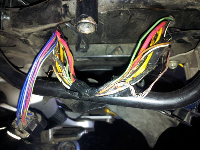

BusaWhipped
May 26, 2005
12,976
103
This is what it looks like when the rectifier stops doing its job.
