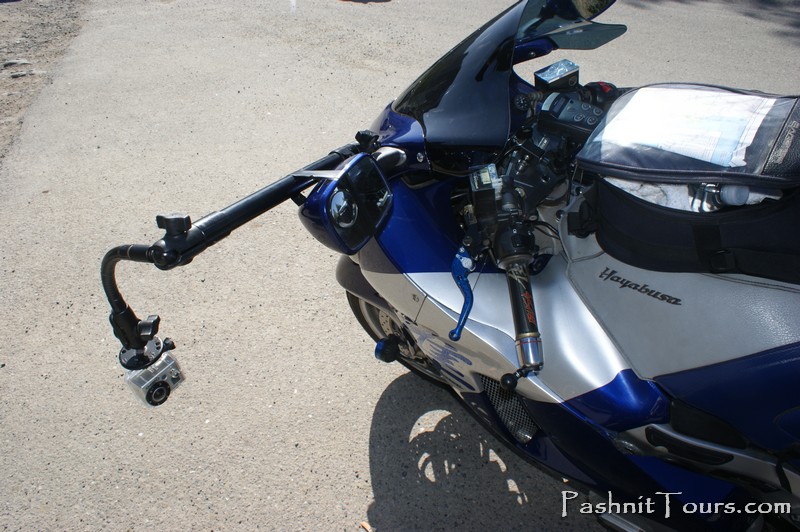

Here's the rest of the story.... Some shots of using the RAM mounts attached to the mirror bolts. As mentioned, very simple to do with the busa. Drill the mounts at just the right spot so they can't rotate and on they go.
Btw, this is the all new (to me) R Series windscreen which I like lot more than I thought I would.
Love the shape, so much that when I got back from this ride, ordered another one in blue. Can't beat the price.
Buy Now: R Series Windscreen Suzuki Hayabusa GSX1300R GSXR | PashnitMoto.com
The general idea is to experiment with getting the camera as far away from the bike and rider as possible which changes the field of vision more.

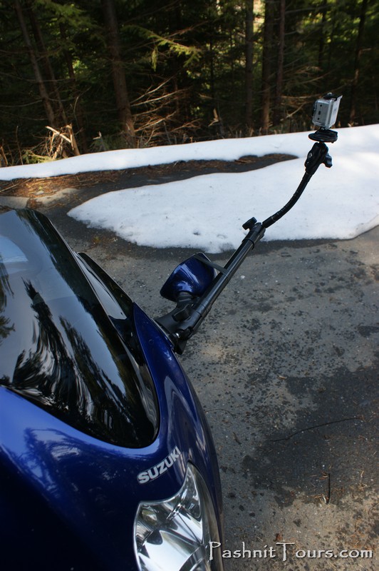

Original idea was this & use the mirror as a support b/c the further you get away from the bike, the more the weight of the arm overpowers the RAM mounts. Tape the RAM arm to the mirror for more support...
Camera up high, you get to see everything like scenery, camera down low- the more the appearance of speed in the shot.
This gave me a shot like this.

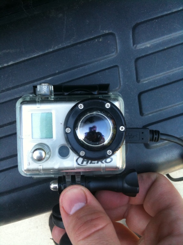

Call it a GoPro Gaffe, but although I've shot 10's of thousands of photos through the years, I didn't bother to clean off the lens before we set off. Doh.
:banghead:
Only downside to this up high shot is there's no point of reference and you have to be really on top of the rider in front of you to have him seem close.
Without the bug on my lens, it should look like this: :cheerleader: Not even close.
