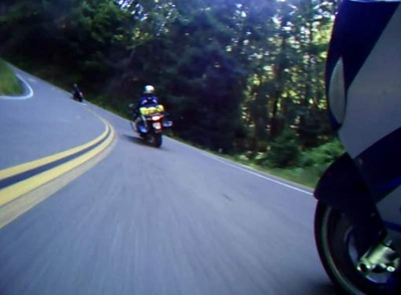

Footage looks like this:
This is footage with the shorter 10" arm off the handlebar.

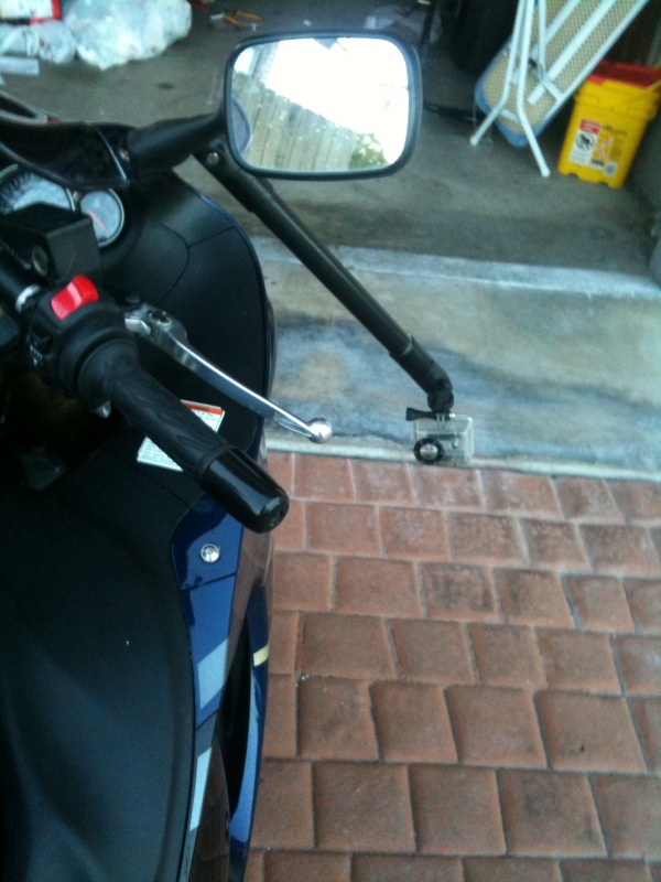

Here's some more development on the mirror mounted RAM ball...
The photo looks like this which I couldn't be more pleased. The trick to the photos is getting just a wee bit further away from the motorcycle than the RAM arm pictured above.

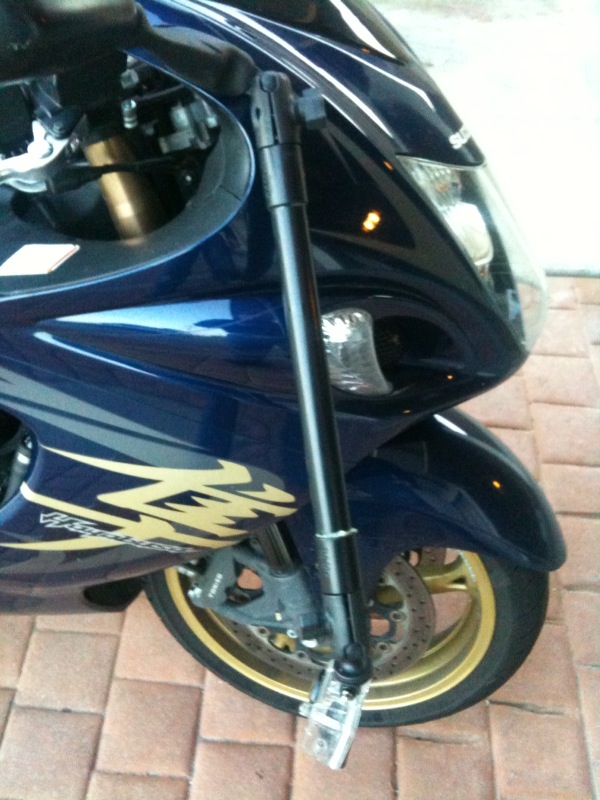

Original idea was this...
Note the electricians tape... :laugh:
I've tried the double arm idea before but the setup didn't work very well due to the weight of the arm overpowering the carrying capacity of the RAM ball.
