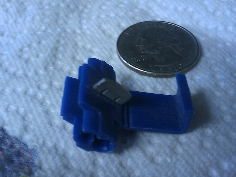

I also thank your quarter! It did a wonderful job! :beerchug:

Thank my quarter, too! He worked awfully hard! :laugh:
And thats about all the money you are going to have left after adding all the mods.
I did the temperature sensor relocation to grap the wather temp coming out of the engine and a second fan. Both came from RCC and are a pretty easy install, fan now comes on a couple ticks below the halfway mark and never passes it. been stuck in heavy DC traffic with absolutely no issues. For good measure I did engine ice and a capful of water wetter too.
