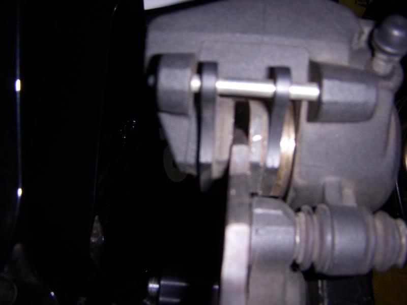

As far as rear wheel it is pretty much a direct bolt on with exception of brake rotor being 240mm Gen 1 compared to 260mm Gen 2. So you either have to have a rotor made with Gen 1 bolt pattern in a 260mm version or switch caliper to gen 1 model which is underslung instead of top mounted and fab a brake bar for caliper or pin caliper bracket to swingarm to lock it in place once mounted.

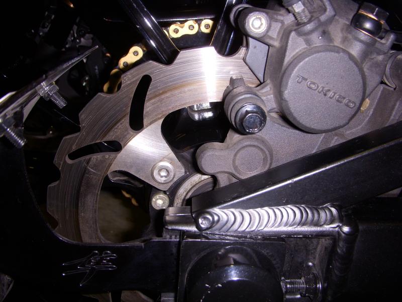

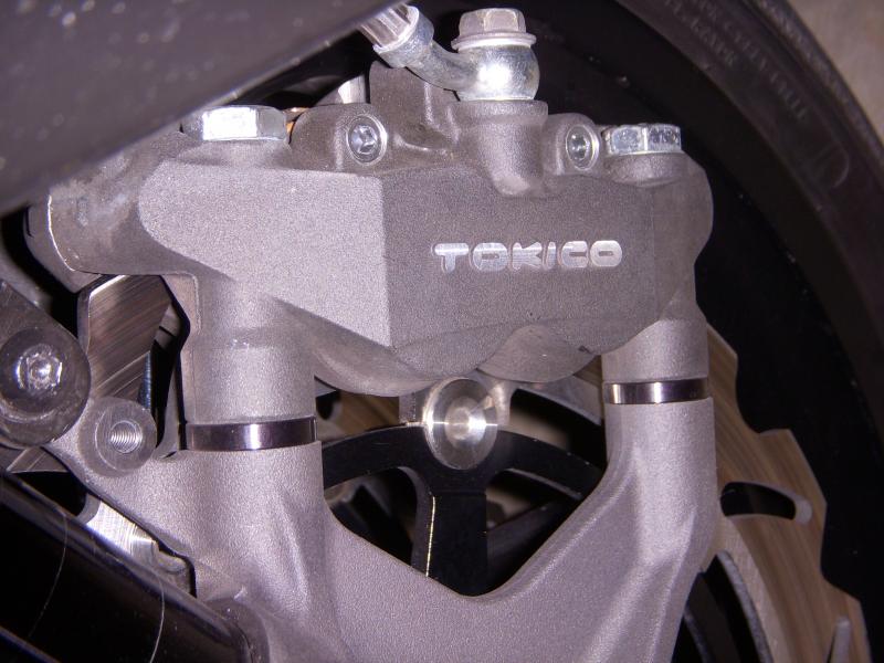

Sorry for the dirty pics just got done riding, but this is the gen 1 bike/wheels with gen 2 front end. And the Gen 2 with Gen 1 wheels you can see how the gen 1 rotor is smaller than the gen 2 set-up needs. Still checking out which way I want to go, I prefer the top mounted caliper so will probably have a rotor made.
