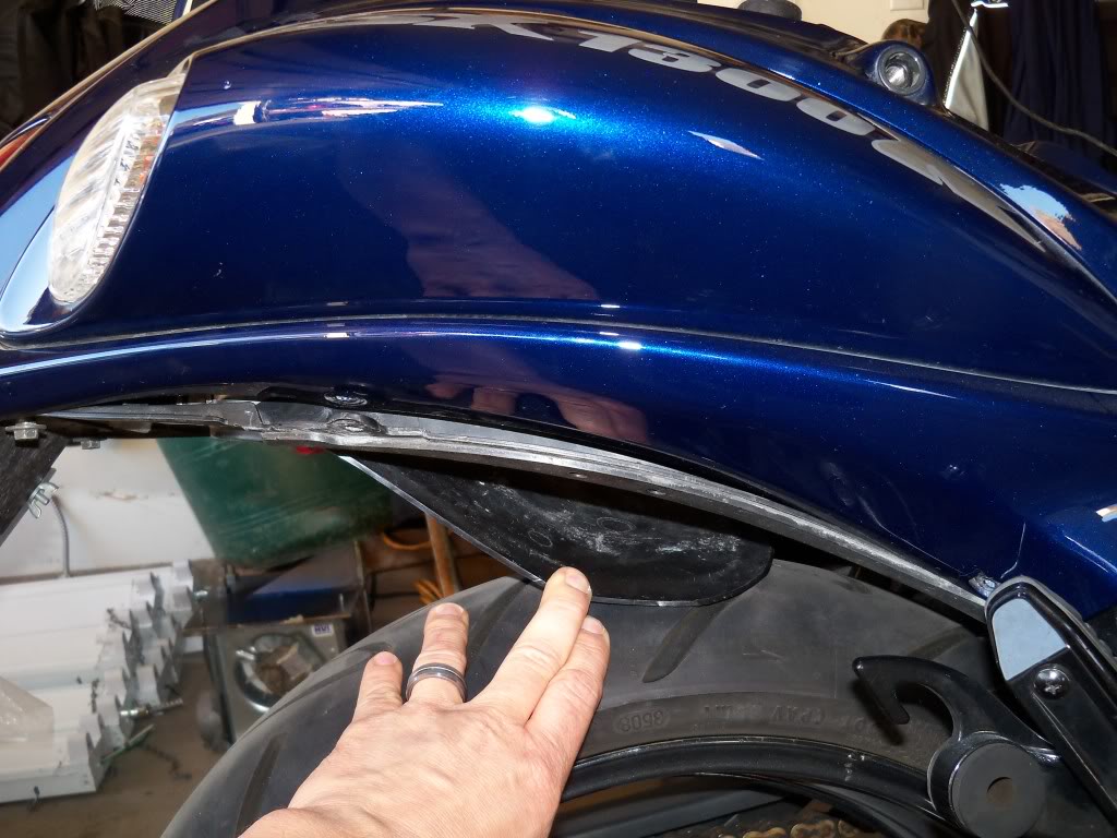

Well, bummer, here is what I had to do. I can repair it some how im sure. In the future, for those that it happens to like me, here is what to do.
The problem with going in from where the drivers seat is that the latch is high up and a black plastic bar on the bottom of the hump really prevents you from getting directly to the round aluminum latch.
Best action is to go in from the right side. Go between the black metal upside down shaped latch and the gap in the plastic. As you can see, there is about a 1/2 inch gap there, use a long metal rod and put black electrical tape on the painted sides. Its a straight shot to the latch as nothing is in the way and its on the exact same level as the crack your going in.
Here is another view from above, just push on the round aluminum latch towards the sprocket side, it pushes real easy. Hope this helps someone in the future. thanks everyone.

Here is a steel rod painted white showing exactly where and how to get her done.
