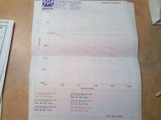

I sent a new 08' shock out to Traxx Dynamics about 3 weeks ago to get rebuit/revalved and heavier spring on there to compensate for 6" stretch and the fact im 290lbs (im not a fat 290 smart a$$es ;-) I got it back on tueday but because ive been stuck working,didnt have a chance to install it until yesterday.let me just say,I am extremely pleased with the difference from the stock (POS) shock and this one,worth every penny,it is rated for 1300lbs,they put a 1" spacer in there,the bike doesnt give an inch,and the ride is very very good.look at the difference in the pic compare the new shock on the left to the stock on the right,you can just see how much they differ
took about an hr to remove and install,remove seat,gas tank,belly pan and battery
