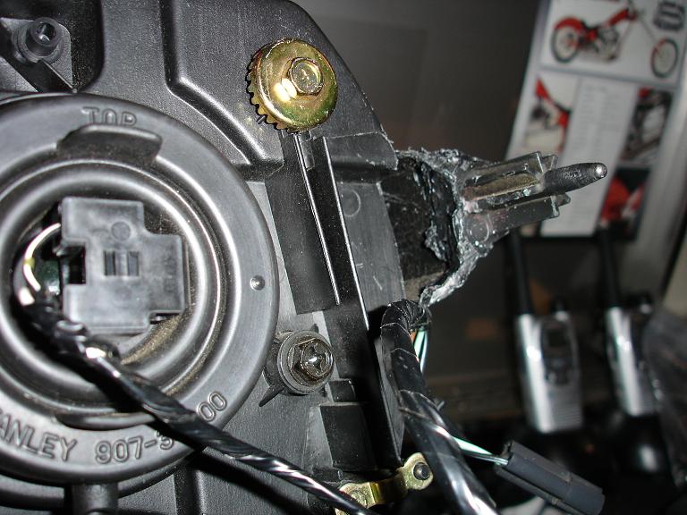

<ul>
[*]Here is a pic of my Headlamp repair. I didn't sand it down to make it look good since it will be hidden. But this save me hundreds of dollars over a new one, since you can't just buy the piece that was broken.
[*]I would post a pic of my fairing welds but they're at the painter and I didn't take any before pics...
[/list]
Fan2zee
Nov 2, 2005
119
Here is a pic of the Soldering Gun I used. And the tip I used is also the one that is attached to the gun on the box.
