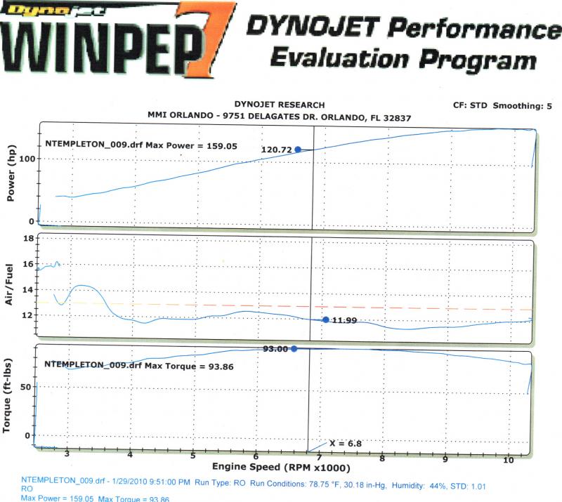

i go to MMI got to dyno my bike but didnt get time to do any adjustments,
2003 l.e. busa k&n air filter full yoshi exhaust, i just got it custom mapped but i need to take it back for hp run oh and i got 31k miles on it

Just curious why its so rich or was that a NOS pull?
Nicholas
Dec 28, 2009
689
at the time of that pull, it hasnt been adjusted correctly yet,
