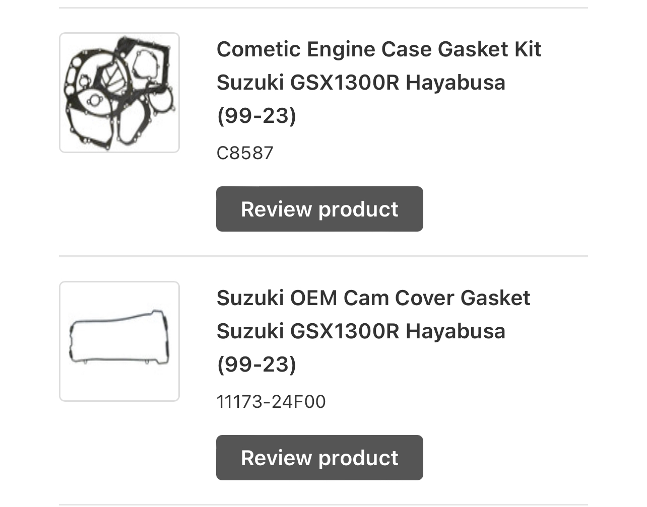

Do you know if the full gasket kit from Gen 2 fits Gen 3?
The dealerships codes are different.
Gen 3 full gasket kit comes from Japan and I have to wait 2 weeks
The Gen 2 kit is in stock and I can have it in 2 days.

In about 2 weeks or so, I will find out if the Cometic Gen 2 gasket kit fits the Gen 3.
Same with the cam cover gasket… that is Gen 2 OEM.
If it doesn’t fit, it will be ugly as the delivery dates for the OEM Gen 3 gasket kit are huge (3-4 weeks as they come from Japan).
I will come back here and let you know the good or bad news. :)

Yes, the parts fits Gen 3.
