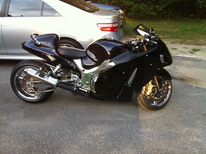

I just had a GSXR1000 swingarm extended 6" to put on my 04 Busa. I haven't installed it yet but holding it up to the bike, Im thinking I didn't go back far enough. Does anyone have pics of a 6" stretch so I can see how it looks I will also be lowering the rear and I want to just barely tuck the center of the rear tire under the tail.

extensions set on 6"

this is mine with a 6" extensions. i'm pretty sure i got a 140 link chain and had to cut it down to 136? but i also have 1 down in front and 2 up in rear, so that makes a difference on lenght also.

another side shot. it is also lowered 2 rear and 1-1/2 front.
