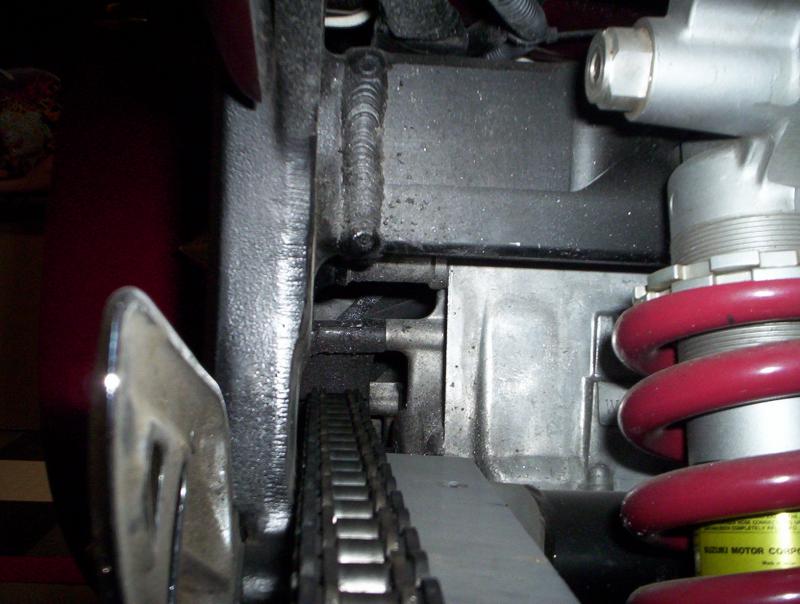

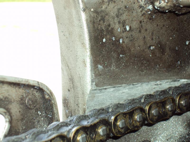

Here you go
I appreciate all of yall responses this is what I got my arm I got from a guy Charlotte name Willis Machines found him on craigslist the whole thing been a nightmare he sent me the arm no axle spacers wrong spacers for the wheels just a bunch of bull@#i@. I have some pics now I can see where the chain is rubbin the frame and is making its on path but I am just concerned with it either eating up the tire or just breaking the chain. But these are the pics please let me know what yall think or if I am on the right path or not.

It may be the angle of the picture but it looks like that chain is still rubbing pretty hard, I think I would get in there with a dremmel and finish off what that chain started, Its already got it marked for you. Also make sure you check the rivots on your chain and make sure you havent ground any down.
Do you have any pics from the rear, Is the tire offset to the right any. It more than likely should be.
I dont have any pics with it from the rear but that was my next move to go ahead and grind some of the frame off with a dremmel. My tire is sitting perfectly centered I dont know if I need to go with a 520 chain instead of the 530 or if grind the frame down some will help
I dont think I have ever seen a 240 sitting perfectly in the middle without a jackshaft but thats not to say it cant be done, But that may be why your into the frame so much and correct me if Im wrong but is the chain also hitting the tire.
I am no expert on this kit, but I would do what I had to get that chain off of the tire and wheel. Is there a spacer missing on that side? Welcome to the oRg.
Like Demmym said, there should be an offset front sproket, at least my kit has one. It will set the chain out towards the frame a bit. You will have to grind part of the sproket cover as well. Looks like you need to get in there and make room for the chain. No idea on spacers for ya.
