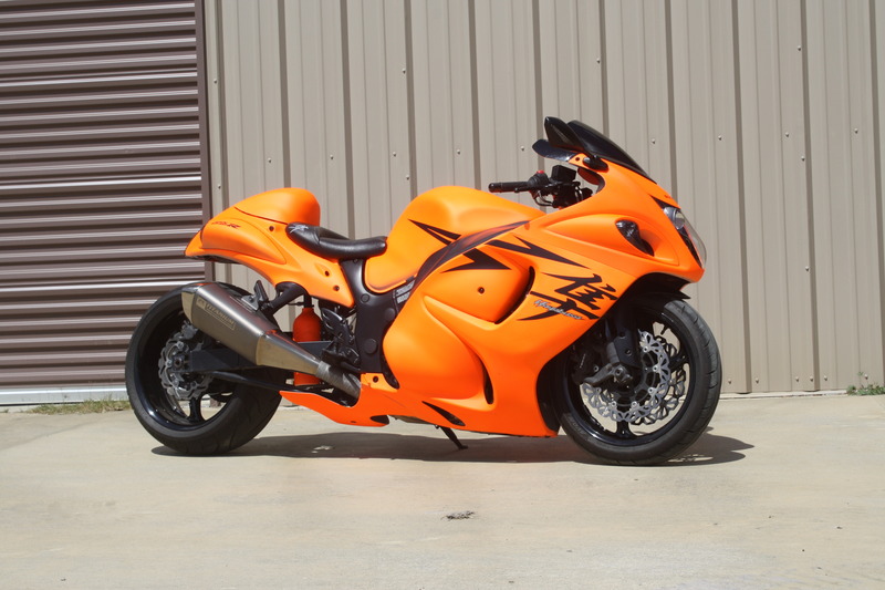

Years ago I fabbed undertail exhaust utilizing an HMF Big Bird Header w/ Yosh undertail slip on.
