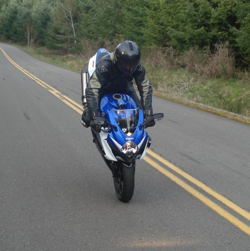

So Tuff, do you think your age has had an effect on your braking distances?
It's a shame Hos, that we grow old so soon and wise so late!
And to answer your question "I doubt it"!
outlawbusa
1 wheel up aero testing
May 22, 2009
6,163
72
Wonder where all those front tire smilies came from? :laugh:
Tufbusa
Track Coach / TufPoodle Coach
Sep 20, 2004
8,026
83
In the upper left hand corner of that photo is the entry to a corner. That could have something to do with it, I'm not sure. :dunno:
